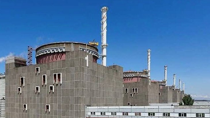

⚠️ALERT
(Day 10), ZNPP still has no off site/external power. Cooling and safety systems are being maintained by on site diesel/backup generators.
Radiation levels are normal. The risk grows with duration, but there is no current radiological release. IAEA is pressing both sides to restore external power.
As of Oct 3, 2025 (Day 10), ZNPP still has no off site/external power. Cooling and safety systems are being maintained by on site diesel/backup generators.
What’s driving the confusion: The Kyiv Independent piece is accurate on the key point,... ZNPP has been disconnected from the Ukrainian grid since Sept 23!
Some posts/tweets saying “power restored” refer to the separate Chornobyl/‘Chernobyl’ site, which indeed suffered a temporary outage on Oct 1 but was restored after several hours. That is not ZNPP.
Context / risk notes:
All six reactors are in cold shutdown, which sharply reduces, but does not eliminate risk. Prolonged total loss of AC power (if generators fail/refueling interrupted) would be EXTREMELY hazardous. This is why IAEA calls the situation unstable and wants grid power restored ASAP.
